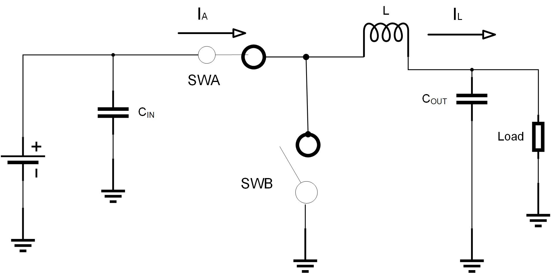

Figure 1 shows a basic buck converter circuit and corresponding waveforms when SWA is on.
Figure 1: Basic Buck Converter Circuit (SWA Is On)

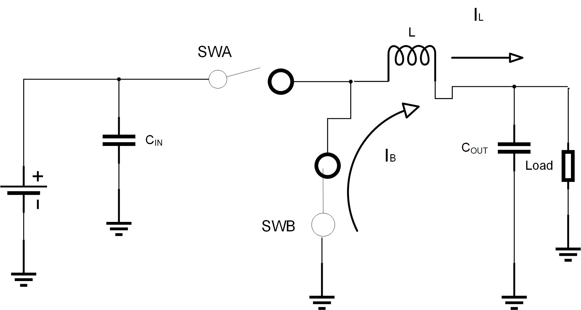

Figure 2 shows a basic buck converter circuit and corresponding waveforms when SWB is on.
Figure 2: Basic Buck Converter Circuit (SWB Is On)

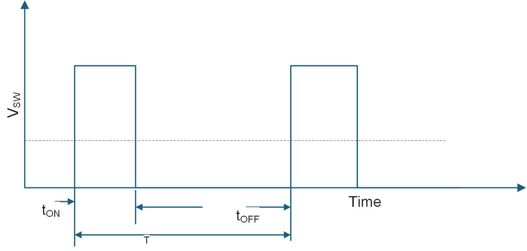

Figure 3 shows the converter’s switch node voltage waveform.
Figure 3: Converter’s Switch Node Voltage Waveform

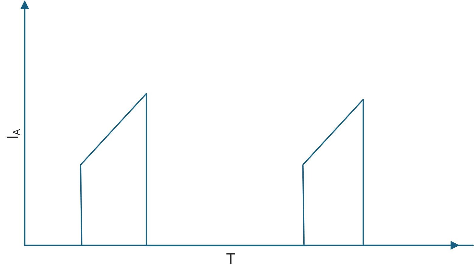

Figure 4 shows SWA’s current waveform.
Figure 4: Converter’s SWA Current Waveform

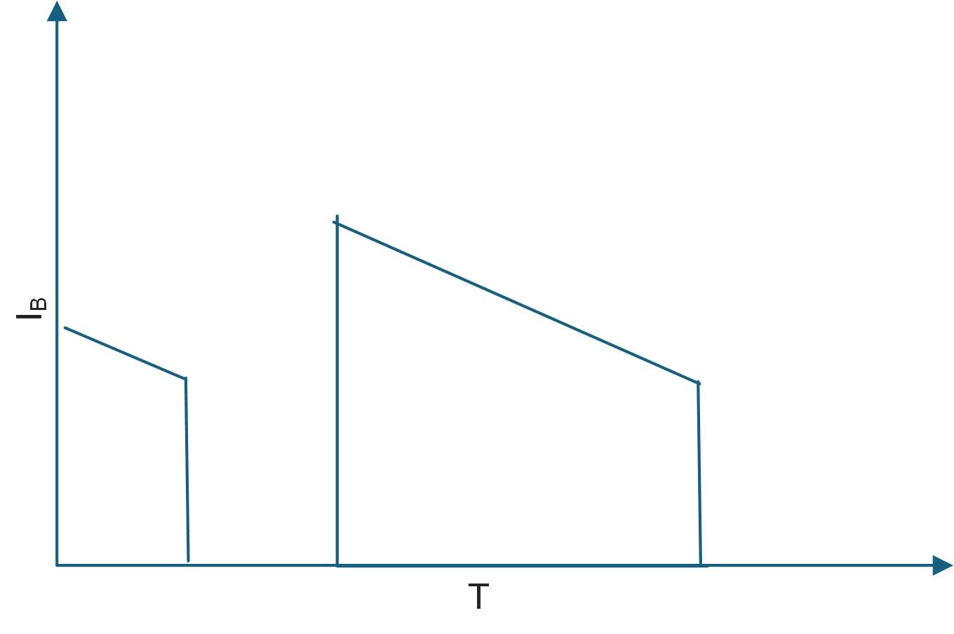

Figure 5 shows SWB’s current waveform.
Figure 5: Converter’s SWB Current Waveform

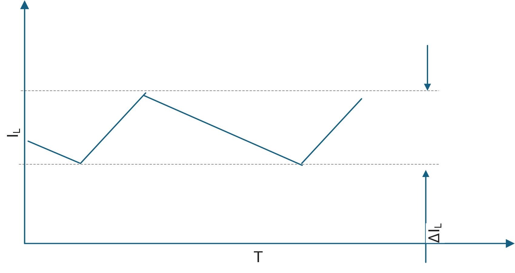

Figure 6 shows the converter’s output inductor current waveform.
Figure 6: Converter’s Output Inductor Current Waveform

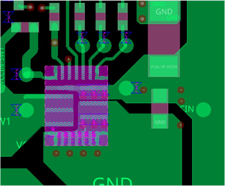

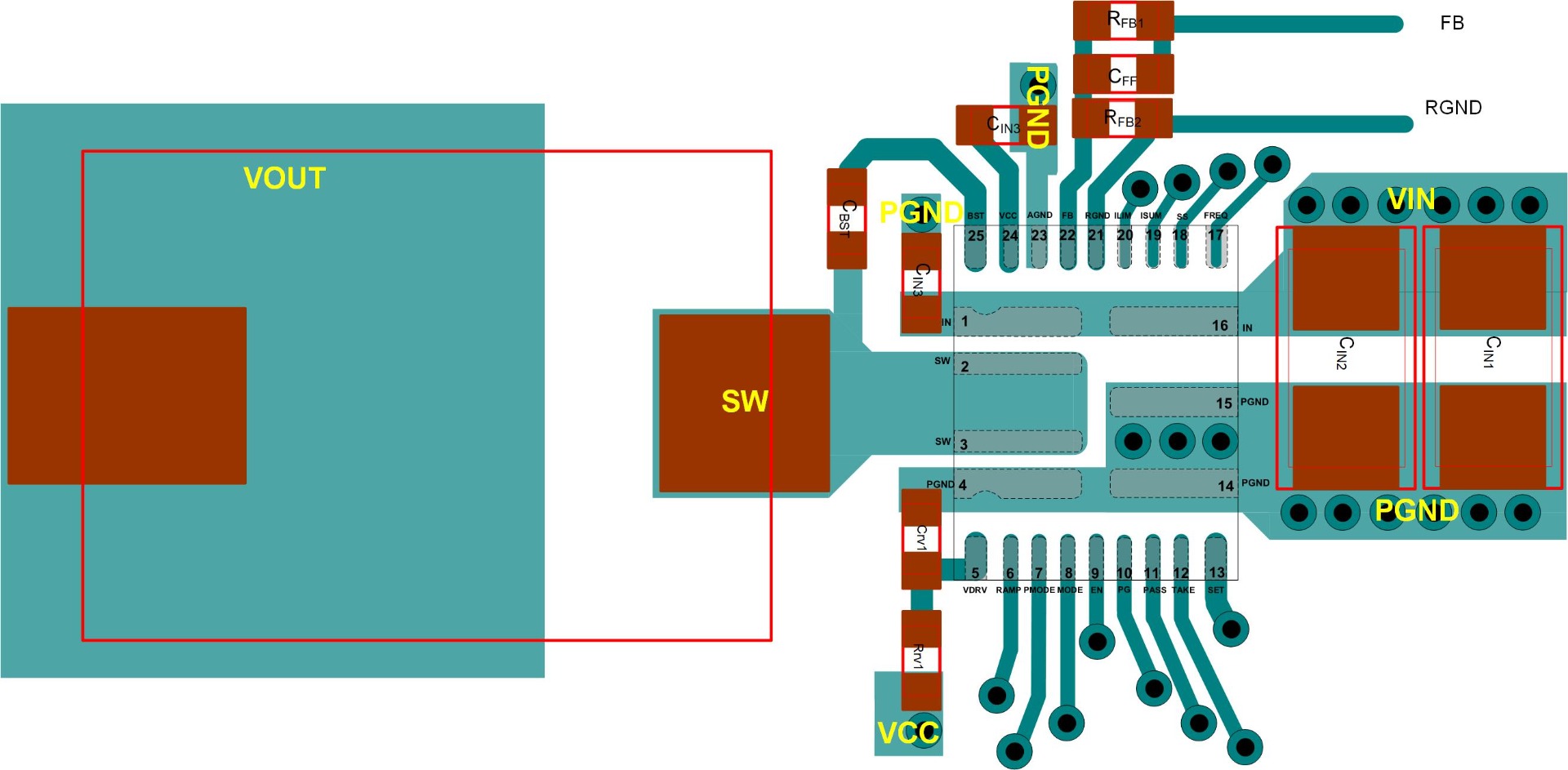

To ensure that these capacitors operate efficiently, it is important to minimize parasitic serial inductance between the input capacitors and converter’s IC terminals. Figure 7 shows an example of an optimized layout using the MP8796, a synchronous buck converter. The input capacitors (CIN1 and CIN2) are placed in the path at the input and return currents next to the IC input terminals. To attenuate the input ripple, these devices should be connected as close as possible to the upper FET drain and synchronous FET source with an additional capacitor (CIN3).
Figure 7: Recommended Layout for the MP8796 Converter
Figure 8 shows how the input capacitors can be placed ineffectively. Only one small ceramic capacitor (denoted in the red box) is placed efficiently with a minimum parasitic inductance. Meanwhile, other capacitors (denoted in the yellow box) are technically connected to the same node. The larger capacitors have more capacitance and a significantly higher parasitic inductance between their terminals and power converter terminals, which means that their impedance is too high to effectively filter out high frequencies.
