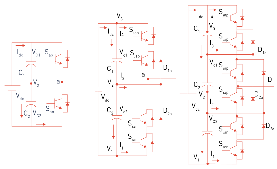

Diode-Clamped Multilevel Converter (DCMC)
Structure and Operation: One of the most popular multilevel converter topologies is the Diode-Clamped Multilevel Converter, also referred to as the Neutral-Point Clamped (NPC) converter. A series of capacitors are employed in this topology to divide the DC bus voltage into several levels, and clamping diodes are used to link each level to the proper phase output. By limiting the switching devices' exposure to a small portion of the overall DC bus voltage, the diodes efficiently "clamp" the voltage levels, lowering the voltage stress on each device.
Figure 11: Two-level, three-level and four-level inverters
Advantages:
- Reduced voltage stress on power devices enables the use of lower-rated components.
- Enhanced harmonic performance in contrast to converters with two levels.
- An excellent fit for high-power applications like HVDC systems and medium-voltage drives.
Challenges:
- As the number of levels rises, the number of clamping diodes also rises, increasing complexity and potentially causing issues with reliability.
- For higher-level converters to function properly, the capacitor voltages must be balanced.

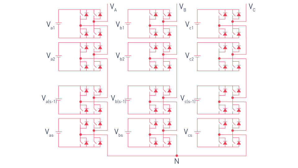

Cascaded H-Bridge Multilevel Converter (CHBMC)
Structure and Operation: The Cascaded H-Bridge Multilevel Converter consists of numerous H-bridge inverter units connected in series on the AC side. A different DC source, such as a battery, solar panel, or other energy storage device, powers each H-bridge unit independently. Because the CHB topology is modular, the converter can produce a highly granular output voltage waveform with numerous levels by cascading multiple H-bridge units.
Figure 13: Three-phase wye configuration CHBMC
Advantages:
- Easy scalability to higher voltage levels and powers is made possible by modular design.
- Excellent output waveform that requires minimal filtering.
- Each H-bridge unit functions separately, which provides fault tolerance and redundancy.
Challenges:
- Need several separate DC sources, which can make the design of the power supply more complicated.
- Higher costs and potential reliability issues result from the number of components increasing linearly with the number of levels.
- Coordinating the operation of multiple H-bridge units requires complex control strategies.

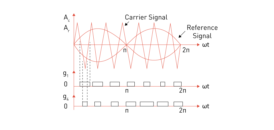

Sinusoidal PWM (SPWM)
One of the most popular modulation methods in power electronics is sinusoidal PWM (SPWM). Multiple triangular carrier waves that correspond to each voltage level are compared with a sinusoidal reference waveform, or the intended output voltage, in multilevel converters using SPWM. The places at which the sinusoidal reference meets the carrier waves determine the switching instants of the converter's power devices.
The output voltage of a three-level converter is determined by comparing the sinusoidal reference with two triangular carriers. A staircase waveform that resembles the sinusoidal reference is produced when the switching devices are activated in response to the comparison. A high switching frequency and precise control over the output voltage are the results of the triangular carriers' frequency, which is often significantly higher than the reference waveform's frequency.
Figure 14: Gate Signal Generation in Sinusoidal PWM
Advantages:
- Widely understood and easy to implement.
- Efficient in minimizing lower-order harmonics.
- Ideal for uses where moderate to high switching frequencies are required.
Challenges:
- May lead to increased switching losses because of the carrier waves' high frequency.
- In certain applications, especially high-power systems, THD reduction might not be the best option.

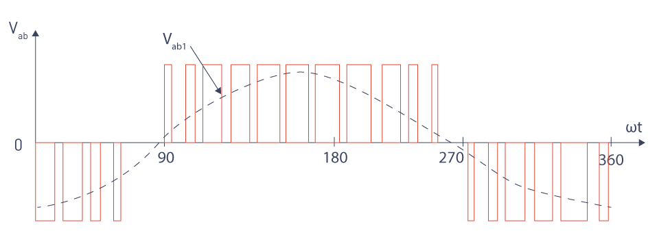

Space Vector Modulation (SVM)
An advanced PWM technique called Space Vector Modulation (SVM) uses vectors in a two-dimensional plane to represent the inverter's output voltages. The main idea is to approximate the reference voltage vector by switching between the multilevel converter's available voltage vectors in such a way that the error is minimized across the sampling interval.
Figure 15: Example output voltage in SVM
The space vector plane in SVM for a three-level converter is separated into multiple sectors, each of which is linked to a different switching state. To provide the desired output, the converter alternates between the voltage levels by identifying the sector that contains the reference vector. SVM is very good at lowering switching losses and making use of the available DC bus voltage.
Advantages:
- When compared to SPWM, it uses the DC bus voltage more efficiently.
- Reduces switching losses by limiting the number of switch transitions.
- It produces lower THD in the output waveform, making it appropriate for high-performance applications.
Challenges:
- More difficult to implement, requiring a thorough understanding of space vector theory.
- Computationally intensive, especially for converters with a large number of levels.

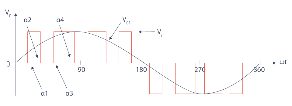

Selective Harmonic Elimination PWM (SHE-PWM)
Selective Harmonic Elimination PWM (SHE-PWM) is a technique designed especially to remove particular harmonics from the output waveform. In order to minimize or eliminate certain harmonics while maintaining the required fundamental voltage, a set of non-linear equations that determine the switching angles must be solved.
Figure 16: Typical Output Waveform for 3rd, 5th, and 7th Harmonic Elimination with SHE Modulation
To remove the selected harmonics, the switching angles in SHE-PWM for a multilevel converter are precalculated. The timing of the switching devices is then managed by these angles. The technique entails resolving a set of transcendental equations, which can be computationally demanding, particularly when trying to eliminate higher-order harmonics or for converters with more levels.
Advantages:
- Capable of removing specific harmonics to achieve extremely low THD.
- Ideal for applications such as power quality improvement devices, where harmonic performance is crucial.
- Eliminates the need for extra filtering components.
Challenges:
- The non-linear equations can be complex and time-consuming to solve.
- Limited flexibility because the switching angles are fixed and must be adjusted if the operating conditions change.

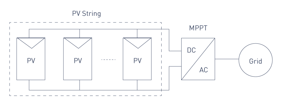

Photovoltaic (PV) Power Plants: Photovoltaic (PV) power plants frequently use multilevel converters to convert the DC output from solar panels into AC power that can be connected to the grid. The cascaded H-bridge multilevel converter (CHBMC) is especially advantageous because solar arrays are modular. An individual solar panel or string can power each H-bridge, enabling scalable, effective power conversion with low harmonic distortion. The overall efficiency of the PV power plant is increased by multilevel converters' capacity to function at higher voltage levels with reduced switching losses.
Figure 17: PV string
