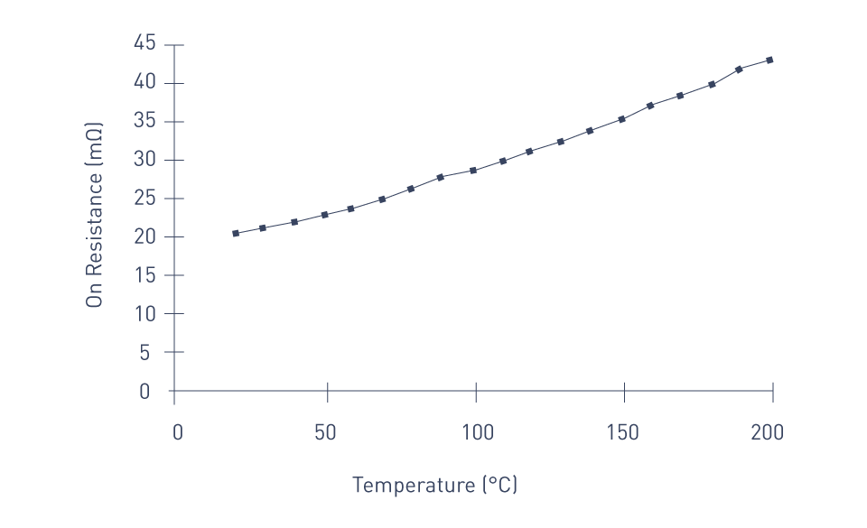

Impact of Heat on Component Performance: Power electronic components' electrical characteristics can alter as their temperature rises, frequently resulting in decreased efficiency and higher power loss. For instance, MOSFETs' on-resistance usually rises with temperature, increasing conduction losses. Additionally, high temperatures can result in thermal runaway, a process whereby rising temperatures induce greater losses and possibly component failure or, in extreme situations, fire.
Figure 11: MOSFET on resistance vs temperature

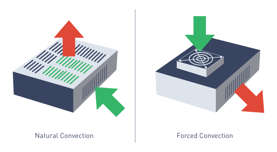

Convection: Moving Heat Away from Components
Natural Convection: Convection is the transfer of heat via a fluid, usually air, that moves heat away from heated surfaces. Natural convection occurs when warm air rises due to its lower density, allowing cooler air to enter and replace it. This is a passive technique that dissipates heat through the natural movement of air. Components should be oriented and spaced to allow for free passage of air, which maximizes cooling effect.
Table 5: Natural vs. forced convection
| Aspect | Natural Convection | Forced Convection |
| Mechanism | Heat transfer occurs due to the natural movement of fluid caused by temperature differences | Fluid movement is induced by an external force, such as a fan or pump |
| Flow Type | Flow is driven by buoyancy effects | Flow is actively generated by a mechanical device (e.g., fan, pump) |
| Efficiency | Less efficient due to slower fluid movement | More efficient because the external force increases the fluid flow rate |
| Applications | Used in passive cooling systems | Used in active cooling systems |
| Complexity | Simpler, no external power source required | More complex, requires a power source (fan, pump) |
| Control | Harder to control, as it depends on temperature differences | Easier to control by adjusting the flow rate |
Figure 12: Natural vs. forced convection
Forced Convection: Forced convection, which usually uses fans or blowers to actively move air across the heat-generating components, is employed when natural convection is insufficient. When compared to natural convection, forced convection significantly accelerates heat transfer, which makes it appropriate for high-power applications. Forced convection considerations include:

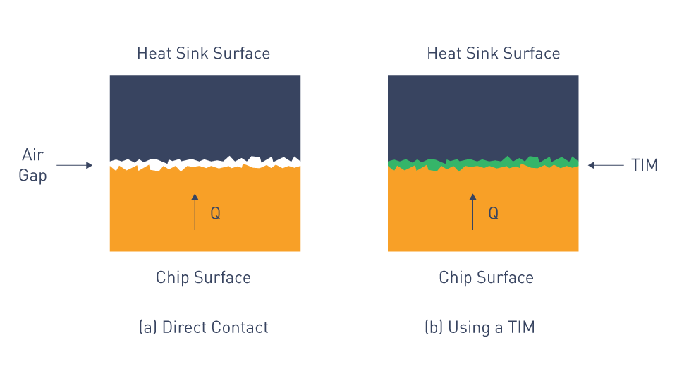

Thermal Interface Materials (TIMs): By decreasing the thermal resistance between surfaces and filling air gaps between heat-generating components and heat sinks, TIMs improve thermal conduction.
Figure 13: Thermal interface materials
Common TIMs include:
- Thermal Grease: To guarantee enough thermal contact and close microscopic air gaps, a paste is applied between the component and the heat sink.
- Thermal Pads: Pre-formed pads composed of materials such as silicone or graphite are employed where set-up is simple and performance is consistent.
- Phase-Change Materials: These materials change state at specific temperatures to improve thermal conductivity when the device is subjected to high heat loads.

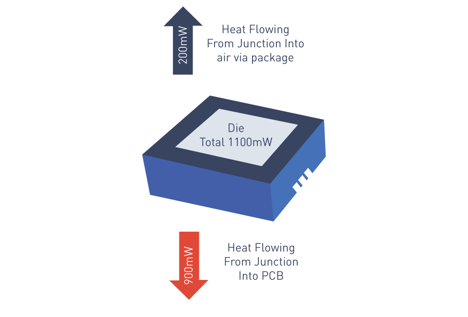

Thermal efficiency in power electronics refers to a system's ability for effectively dissipate heat produced during operation. A thermally efficient design reduces component temperature rise, which improves reliability and life span. Thermal efficiency is achieved by maximizing the system's heat transmission processes, such as conduction, convection, and radiation, while also reducing thermal resistance.
Thermal Resistance and Junction Temperature: The ability of a system or component to transfer heat from its source (such as a semiconductor junction) to the environment is measured by its thermal resistance. Lower thermal resistance improves heat dissipation and lowers junction temperatures, both of which are crucial for power electronic device reliability. To achieve optimal thermal performance, designers need to consider both the case-to-ambient thermal resistance (via the heat sink and cooling systems) and the junction-to-case thermal resistance (within the component).

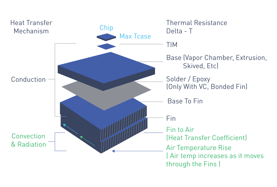

Designing Effective Heat Sinks
Heat Sink Selection and Design: Heat sinks are passive devices that absorb and dissipate heat from power components into the surrounding environment. The effectiveness of a heat sink is determined by its material, surface area, and design. Key factors to consider include:
- Material Selection: The most widely utilized materials for heat sinks are copper and aluminum because of their excellent thermal conductivity. Aluminum is a popular choice for many applications because it is lighter and more affordable than copper, despite copper's higher thermal performance. To balance cost and performance, some designs use a blend of both materials.
- Surface Area and Fin Design: The heat sink's ability to dissipate heat is directly related with its surface area. Fins increase the surface area, which facilitates more effective heat transfer to the surrounding air. To maximize airflow and heat dissipation, fin design, including size, shape, spacing, and orientation is essential. For instance, pin fins can be employed to improve performance in natural convection, while straight fins are straightforward and efficient in forced convection environments.
- Optimizing Thermal Interface Materials (TIMs): Thermal performance depends on the interface between the heat-generating component and the heat sink. TIMs, such as thermal grease, pads, or phase-change materials, are used to fill microscopic gaps between the component and the heat sink, lowering thermal resistance. Properly choosing and applying an appropriate TIM guarantees efficient heat transfer and lowers the component's junction temperature.
- Mounting and Mechanical Considerations: To guarantee optimal thermal contact with the component, the heat sink must be mounted properly. To optimize the TIM's performance and reduce heat resistance, the mounting technique should apply consistent pressure over the surface. Common mounting techniques include clamps, screws, and adhesive tapes; each has benefits specific to the application.
Figure 15: Heat transfer via heat sink

- On-Resistance: The on-resistance of MOSFETs rises with temperature. Increased conduction losses from higher on-resistance lower the power converter's overall efficiency. Additionally, this rise in on-resistance generates more heat, which, if left unchecked, could result in a thermal runaway condition.
