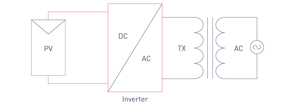

One of the primary functions of power conversion in renewable energy systems is to convert direct current (DC) power generated by photovoltaic (PV) solar panels and certain types of wind turbines into alternating current (AC) power, which is the standard form used by most electrical grids as well as household and industrial appliances. Inverters, which are power electrical devices that rapidly switch the DC input on and off, often perform this conversion process, resulting in a pulsating DC waveform that can be filtered into a smooth AC waveform.
Figure 19: DC to AC conversion
For example, the DC output from solar panels in solar power systems fluctuates depending on the conditions of sunlight. As a result, the inverter must not only convert the power but also regulate it to maintain a constant output voltage and frequency that matches grid standards. To maximize the energy supply from solar panels and guarantee a smooth integration with the grid, this conversion must be carried out properly and efficiently.

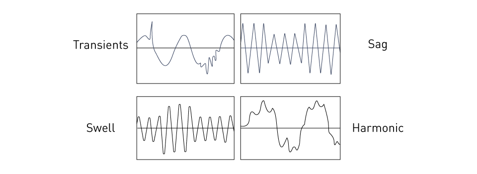

Another crucial function of power conversion in renewable energy systems is maintaining power quality. Renewable energy generators' non-linear characteristics and power output variability can lead to power quality issues like flicker, swells, sags, and harmonic distortion. By removing harmonics, regulating the flow of reactive power, and stabilizing the voltage, power converters are designed to help with these issues.
Figure 20: Types of power quality problems
For example, advanced control algorithms that actively monitor and address power quality issues are frequently used in PV system inverters. In order to maintain grid voltage stability, especially in weak grids or during disruptions, these inverters can inject or absorb reactive power as needed. Similar to this, power converters in wind energy systems aid in reducing flicker and other issues with power quality by smoothing out the power output and damping power oscillations.

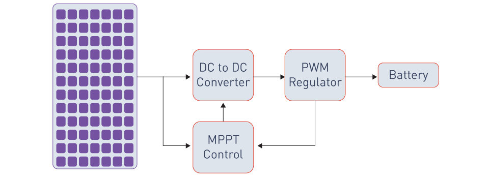

When combining renewable energy sources with energy storage devices like batteries or supercapacitors, power conversion is also essential. Because renewable energy generation is frequently sporadic, wind power relies on wind conditions, and solar power is only available during the day, energy storage systems are used to store extra energy when demand for it exceeds supply and to provide energy when generation is insufficient.
Figure 22: MPPT Charge Controller
Power converters enable the bidirectional flow of energy from the renewable energy source to the storage system and the grid. When energy is abundant, they make sure it is stored efficiently and retrieved when needed. In a solar-plus-storage system, for example, the power converter charges the battery during the day when solar generation is high and drains it at night or at instances when solar generation is low. This process must be controlled by the converter while preserving power quality and making sure the battery runs within its safe limits.

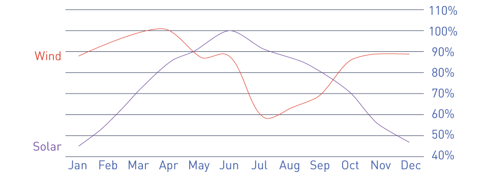

Challenge: The inherent unpredictable and intermittent nature of the energy supply poses the biggest challenge to both solar and wind energy systems. The time of day, the weather, and seasonal variations all have an impact on solar power generation, which causes power output to fluctuate. In the same way, wind power generation is dependent upon wind direction and speed, both of which can fluctuate significantly over short periods of time. These fluctuations make it difficult to maintain consistent power output and grid stability.
Figure 24: Representative power output compared to maximum monthly capacity
Solution: To handle the unpredictability and intermittent nature of renewable energy sources, advanced control systems are necessary. For instance, solar and wind energy systems use Maximum Power Point Tracking (MPPT) algorithms to continuously modify the system's operating conditions in order to maximize power output under a variety of environmental conditions. Furthermore, by storing excess energy during high generation periods and releasing it during low generation periods, energy storage systems, such as batteries, can be incorporated to mitigate the variations. To maximize system performance, control systems must regulate the storage system's cycles of charging and discharging.
